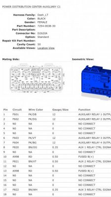

Went out at lunch and pulled my AUX PDC out of the tab mounts and only found a number of "7154-7344-30" on the bottom but that does not come up as any FCA type part number and I suspect is just vendors part number for the plastic shell.
On the dctools website this is the part number however there is no repair part number associated with the PDC.

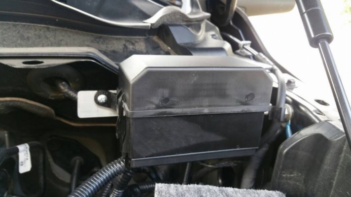

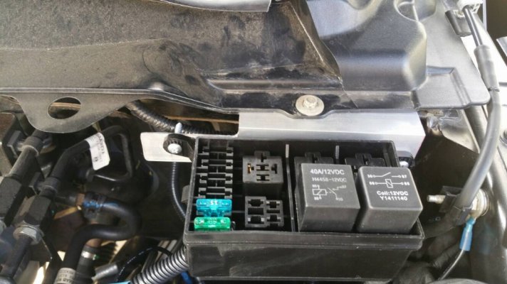

This is just a universal relay block. I added an aluminum bracket to it and mounted it using one of the mounting holes for a cowl fasteners.85f36d954e12e9ff8459e654d646087a.jpgf96dce2b7ce1d9eb7d14b627fc4cd395.jpg

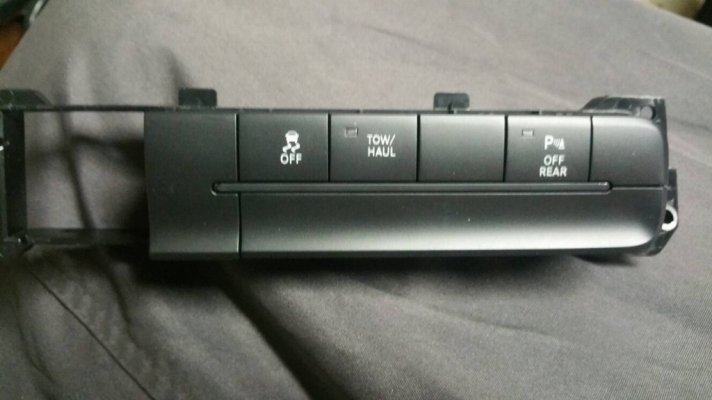

This thread is how I added auxillary switches to my 2016 RAM 2500 with a 6.4. My truck did not have provisions for the auxiliary switches from the factory and the parts folks at my dealer said it was impossible to add the switches after the fact. After a lot of research I began my quest to prove them wrong. The switch in my truck had traction control, tow/haul, rear park assist buttons on top and a blank panel on the bottom?
My factory switch
The switch I needed with the auxiliary switches on the bottom row was PN 68241343AA-001

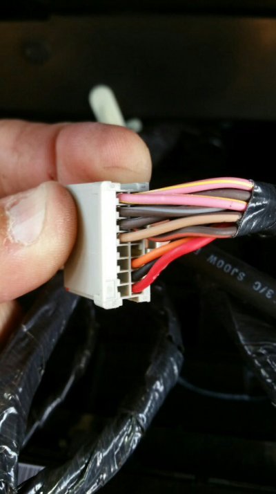

Both switches use a single connector and i was able to incorporate my harness into the existing connector by slicing into the appropriate wires.
I found a wiring diagram on Ram Builder for the 6.4 and it* helped with the design and building my harness. In the factory connector I connected to the following wires.
Aux1 - pin 3 br/or
Aux2 - pin 2 br/vt
Aux3 - pin 11 br/wt
Aux4 - pin 10 br/gy
Aux5 - pin 12 tn/br
