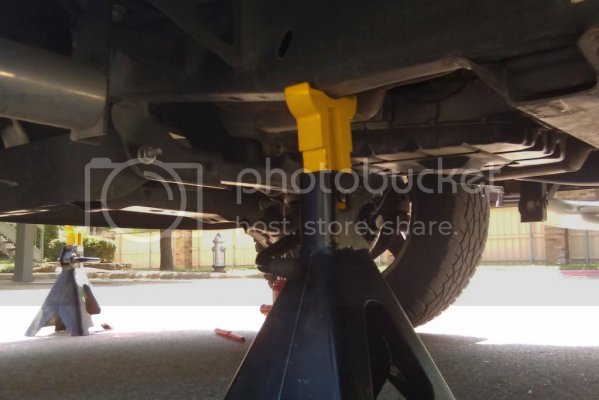

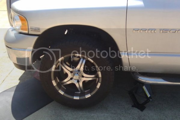

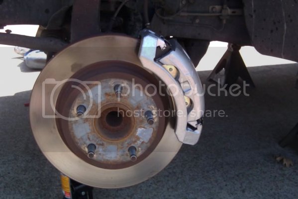

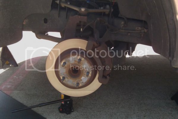

1. Jack the front of your truck up so you can remove both front wheels. I put two jack stands under the frame to help support the truck. And no I didnt jack up the truck on the nerf bar, the stock jack was just there. Never used it lol
2. Remove Wheels

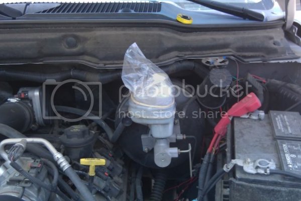

3. Remove Cap on master cylinder so that it wont overflow with brake fluid when you take apart the caliper. You can put a shop rag or plastic baggie to catch the overflow. Mine did not overflow fyi

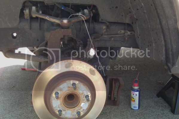

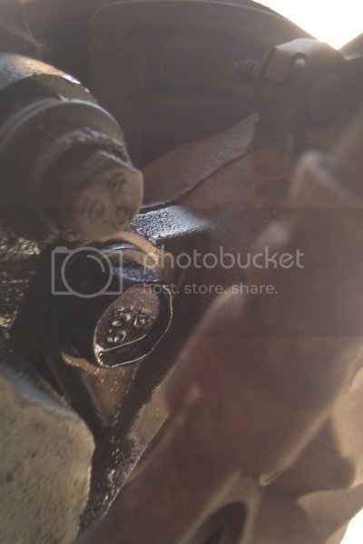

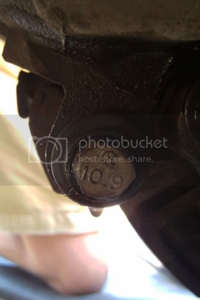

4. Remove the 4 bolts that hold the caliper in place. The bigger bolts are 21mm and the smaller ones are 13mm. Soak good with wd-40 for about 15 minutes so its easier to take them off because they are super tight.
5. Remove the bolts and pull the caliper of the rotor. Be careful because it is heavy and u dont want to mess up the brake fluid line. I used a wire hanger and rigged it up so it would hold it up.

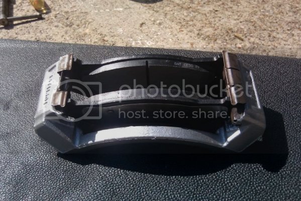

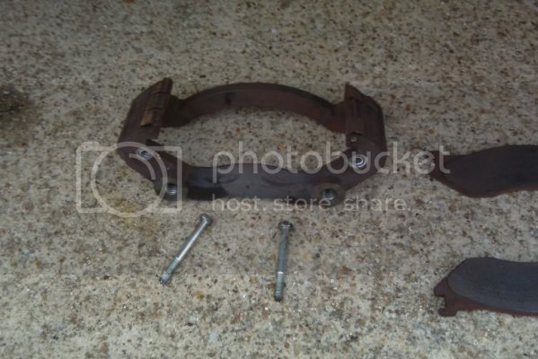

6. Separate the caliper and Remove the old brake pads. they just push out the sides.

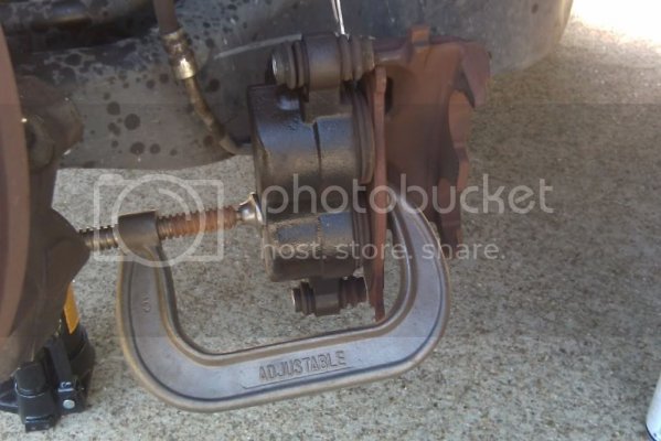

7. Now you need to compress the piston. Get a c-clamp and one of the old pads. Start to tighten the clamp so the pistons compresses.
8. Put the new pads in the caliper. I got ceramic pads so you would want to grease the back of them before you put them in so they wont squeal when you drive them.
9. Put it all back together and tighten all your bolts tight.
