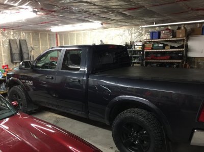

Thanks, here's a few shots of it tucked away. I'll downsize to a 33 for now and see what happens over the next few trips.
