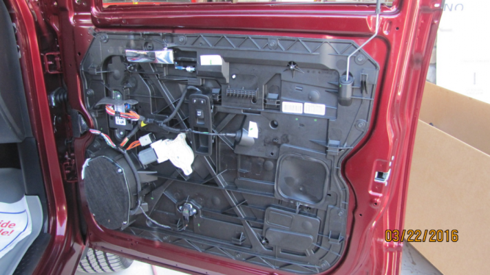

Have you or anyone else taken off the door panel
Believe it or not, when people pull that panel off they don't do it gently & they can easily bend the mechanical lock mechanism.
When that rod gets bent, the door will not lock.
When you press the lock button on the master door switch, you would hear & see the lock mechanism trying to lock
The body shop had the inner panel off too, we thought the actuator was bad, but it was a bent locking rod
If you take the first panel off, like above
You can see the the 5" X 5" rubber cover that is hanging in the pix
If the window was raised & you reached your hand in there, you would feel the lock actuator, if you have a cell phone, you could actually see it & feel it moving or attempting to move.
