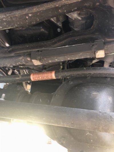

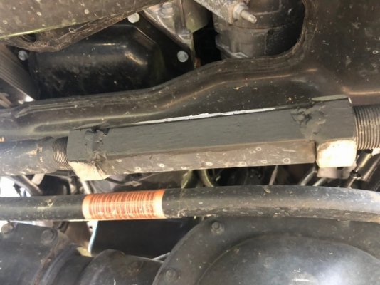

Here is the “fix”. Chicken **** if you ask me.
2018 2500 6.4 4x4 4.10 Amsoil SS 0w-40, Softopper
Black Rhino Armory 18x9 +12mm
Cooper St MAXX LT295/70R18
2016 Durango 5.7 AWD 3.07 Amsoil SS 4 Qts 5W-30 and 3 Qts 0W-40
1996 Nissan Altima 2.4 Amsoil SS 5W-30
Fix? They didnt fix ****! Lol
They welded it because it was tight. So what was the issue in the first place then?
