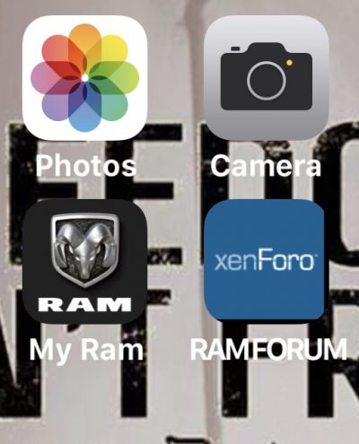

Be sure to note it in your “my Ram app” under maintenance records. JMHO

I was not aware of said app. Are you referring to the Ram Box app by chance?

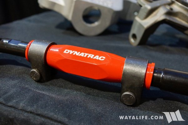

I would like one of these for our trucks. but no one makes one yet.
