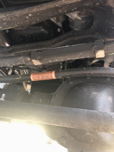

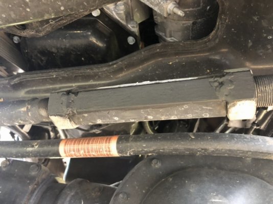

Here is the “fix”. Chicken **** if you ask me.

Hey, somebody put black play-doh blobs on yer draglink.
RoadRamblerNJ
Aug 26, 2017
2,260
2,397
Mountain City, TN
392 Hemi
Fix? They didnt fix ****! Lol
They welded it because it was tight. So what was the issue in the first place then?
Exactly! Just so I'm clear on this...
They check it. If it's loose, they tighten it but if it's tight, they weld it?
Logically, the tightening would then make a weld necessary, so Weld 'em ALL and let God sort 'em out.
Yep, and if this is a temp fix cool, if this is their permanent solution, there will be issues.
I’m engaged with the RamCares team and I’ll see what they say/where it goes.
I honestly could have welded it better.
