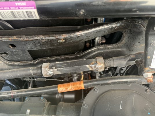

Recall information; had this done last week. Drag Link V06 recall!
Man what a total s**t job! Sorry to see that. I could have done better when I was 15 yrs old. Didn't even take the time to clean it and paint the welded area.
This continues to be one of the poorest handled recalls/issues I've ever seen, period.

I just bought a synergy after seeing the **** poor weld job my dealer did. This needs to be a law suit. If they think welding something is the fix when this is a service able part is just a bad business idea.
I'm one of the least litigious people out there....but on this issue I must agree. It's sad when your forced to consider sueing to force an entity to do the right thing, when the right thing to do is very obvious.
Our trucks were sold to us with an adjustable drag link and any recalls done should return the trucks to at least the same condition it was pre-recall and not worse.
Why would anyone accept a welded/altered steering component from a major automaker/oem that now does not function as originally designed?
We shouldn't! It's just plain wrong.

After viewing the photo posted above I must agree with others that this is getting plain stupid.. If someone did that to my truck they would be replacing the entire drag link. My dealership keeps wanting to do the "recall" but I told them until they have a replacement part not to touch mine in anyway or form. FCA has definitely dropped the ball on this and I can only wonder how long it's going to take for them to wake up. I have checked the torque on mine on several occasions and have never found it to be even remotely loose,,,

Here’s the **** job the dealer did on my dads truck, not even gonna consider them doing this on my truck, absolutely ******* ********

Yeah looks pretty sloppy. My sons was already done when he bought his but it was at least a clean weld and they painted over it. Mine hasn't been done and I don't plan on letting them do it. My son's is the same as mine (2018 2500)

That’s my fathers 2018 3500 laramine, only has 2200 miles on it (yes it’s gonna be 2 years old with only 2200 miles, he bought it, and a month lather went out of work sick, and shortly after found out he has cancer) I know once he sees it, he’s gonna flip, I’m gonna get some spray paint and “touch it up” as this 2cent fix is ******** on his $70k truck
What in the absolute f*ck is that! I can't believe they considered that an acceptable fix!

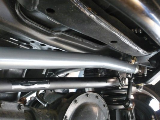

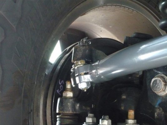

Yes, unfortunately there is a lot of incorrect info about this recall. Also unfortunately, I think Ram itself is responsible for some of that wrong info. After reading all I could about this recall, as I understood it the welding was a temporary fix for any drag link that failed inspection by a dealer. That then a permanent solution would at a later date become available. Many took the welding fix as a permanent fix. Here is where I think Ram dropped the ball and should have been more transparent on just what was to happen.
This lead many (including myself) to seek and install an aftermarket fix not wanting to wait, or deal with a dealer, and taking pot luck on how good a welding job was going to be. The most favored aftermarket part apparently is the Synergy Drag Link. I bought and installed this myself as well. Its well made and solved the problem. I pasted pics below of the part on my 2017 Ram 2500.
I also pasted below a short youtube video showing the NEW part Ram will apparently be implementing as the part to be used as the permanent fix. If you look closely at the part (especially the adjustment sleeve/nut) you will notice an uncanny resemblance of the new Ram drag link to the Synergy one. ( the new Ram drag link in the video is the one with a dull black finish and is directly above the track bar which is gloss black with an orange sticker on it).
