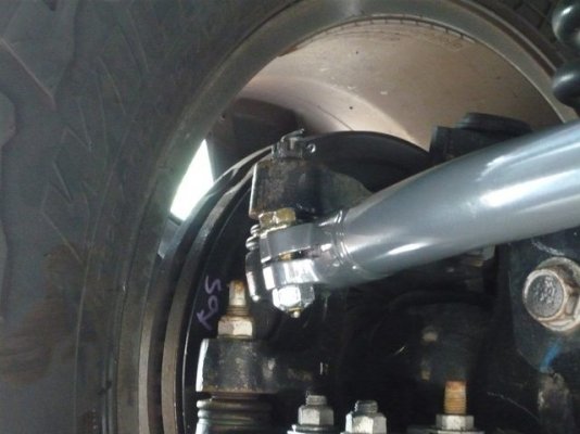

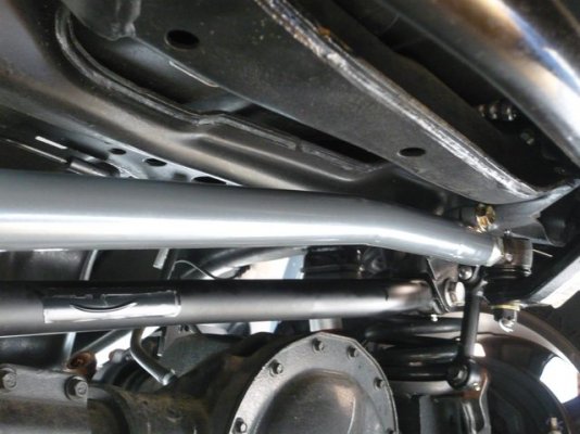

Yes, unfortunately there is a lot of incorrect info about this recall. Also unfortunately, I think Ram itself is responsible for some of that wrong info. After reading all I could about this recall, as I understood it the welding was a temporary fix for any drag link that failed inspection by a dealer. That then a permanent solution would at a later date become available. Many took the welding fix as a permanent fix. Here is where I think Ram dropped the ball and should have been more trasparent on just what was to happen.
This lead many (including myself) to seek and install an aftermarket fix not wanting to wait, or deal with a dealer, and taking pot luck on how good a welding job was going to be. The most favored aftermarket part apparently is the Synergy Drag Link. I bought and installed this myself as well. Its well made and solved the problem. I pasted pics below of the part on my 2017 Ram 2500.
I also pasted below a short youtube video showing the NEW part Ram will apparently be implementing as the part to be used as the permanent fix. If you look closely at the part (especially the adjustment sleeve/nut) you will notice an uncanny resemblance of the new Ram drag link to the Synergy one. ( the new Ram drag link in the video is the one with a dull black finish and is directly above the track bar which is gloss black with an orange sticker on it).
431857[/ATTACH]']N74SwtRl.jpg
431859[/ATTACH]']RARuCjSl.jpg
