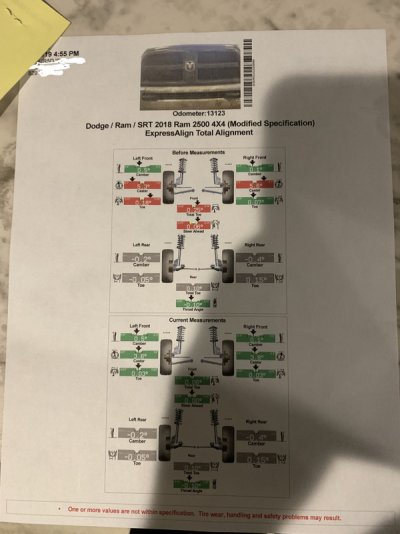

Son bought his 2018 6 weeks ago and his was already welded. He got new tires today and they checked the alignment and it was off. Not sure if they said anything about the welds but they did re-align it

did you see the alignment machine printout ? my 17 had a good factory alignment. sucks if yours was off

i did see the printout. have a copy on my phone. i haven't really looked but my son said it was pretty far off

No idea. I know very little about alignments

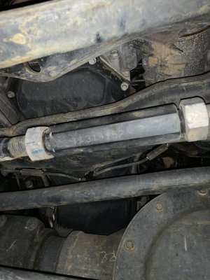

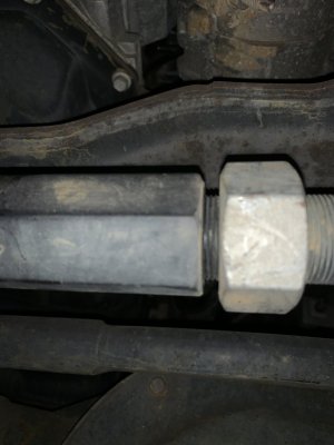

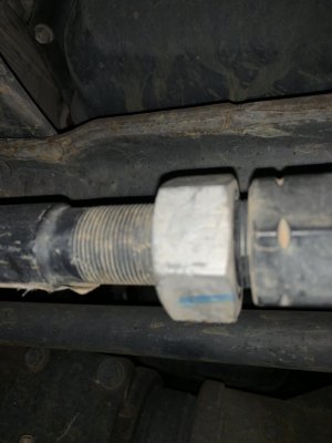

2014 with 59535 Miles. I check the drag link at least every 8000 miles/oil change. Guess I’ll tighten it back up and consider V06 tack welds.
My steering wheel rapidly became off center tonight. Checked drag link adjuster jam nuts and this:
DBC19232-1C5E-4F09-8B1D-6790CFD3A589.jpeg 2A670426-55E6-47F0-ADB2-7C0441F57B32.jpeg F2BAF7E3-930B-43B0-A026-F60CC62D128A.jpeg

Pretty good chance that the threads on your drag link sleeve are out of spec. I’m willing to bet it pulled apart. That’s why the adjusters are welded to the sleeves. It essentially makes it one big nut with good threads on either end.
The threads on the nuts don’t have any issues so they won’t be pulled apart.
I know there people that refuse to get the recall, but that is a good example of why just checking the nuts if they’re tight doesn’t mean it’s ok and nothing can happen.

No mud on those 3 threads either. Sure looks like it pulled apart, causing your rapid off center steering wheel.
