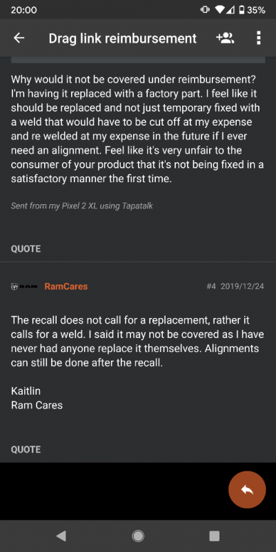

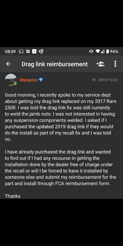

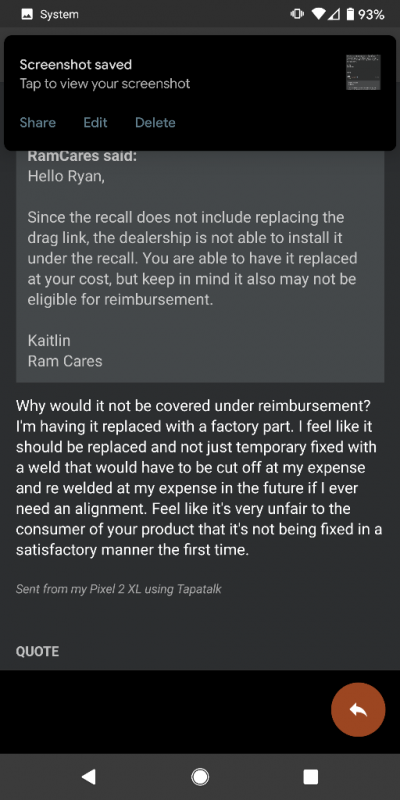

Wow you actually bought the part and they turned you down saying the recall doesn't call for a new part what a bunch of BS. Not only did I get about the same response as you. There is a new part if the threads are jacked up which I will post and it's off of FCA's paperwork on the recall they give to the dealers/mechanics. I would be so mad if I shelled out money for that part and they were like oh nope doesn't call for a redisigned part lol jesus. Anyways the 19s, 20s have the new SAFE part but FCA's TO CHEAP to do the right thing. I am expecting a call from a supervisor tomorrow and I refuse to let this go now after hearing yours to. They want to put everyone's life at risk and my family's fine I will call everyday or time to get an attorney. In my pics below you can see a new part and one of my conversations.

A lot of guys have been getting the reimbursement for the part but I'm not sure about the install. I just think it's pure BS that if you buy a Mopar certified part they will not install it under the recall

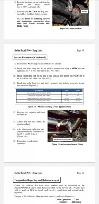

I may have to check that out. I wonder if anyone has the part number for the new drag link. If not I think it's on that paper I have about the repair procedure. It just sucks they seem to not care and are making everyone shell out more money.

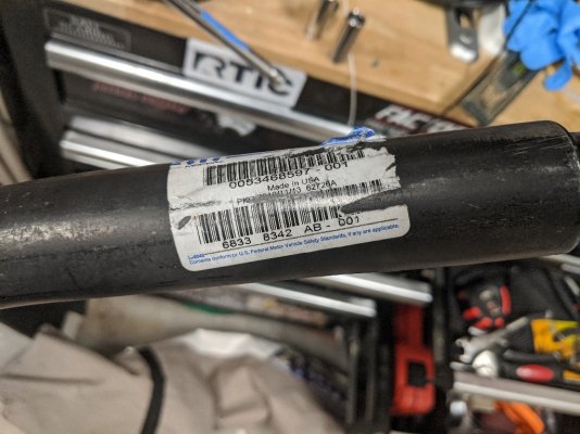

Here's the part #68338342AB
I ordered mine from Mopar parts giant, alot of place have them though.

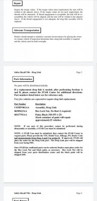

This is off the spec sheet for a different drag link if STAR was to get involved. This part I think has the clamp on it.

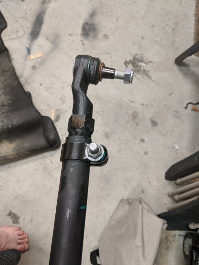

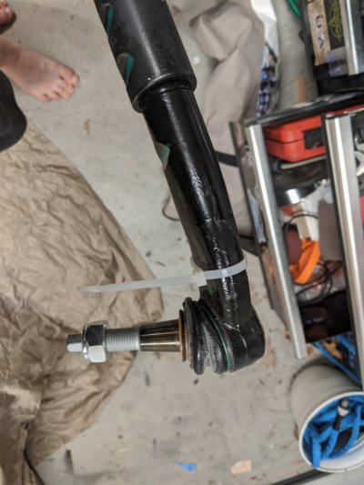

This is the one I got, I used the same part number as a few guys on a wagon page on facebook pretty sure @IRSmart used this # for his.
It does not come with new nuts though, they gotta be ordered seperatly 9a8cafbf66b23e3e930d8df68270bdd9.jpgb9c5af6292c62fab11f40030cd8d56bd.jpge431003d448ddb67db77de1ffe562c41.jpgefaea137a8f803ce7333c78cd46f5c9d.jpg

Correct. DO NOT order the part number in the recall. That means you’re ordering from the pool of people in line for the recall. Order the part number stamped right on the drag link itself. That bypasses the recall part number and you get it faster (and cheaper).
Edit: oh, and I just installed the part myself. Having my service department do it was never an option. Even being the manager of the store got me no preferential treatment. I’ve had service tickets open for months before I got any work done. I wouldn’t be surprised if my RO for the drag link recall is STILL open. I just did it myself, took me maybe an hour. The assembly wouldn’t come loose on the pitman arm side and took forever to get off. I wound up having to put the puller on the nut, tighten it down until it started to bend, then turn the wheel left and right. I heard a loud BANG! and looked under the truck. Low and behold, the assembly had come loose lol

Man that's way better than the one on there now. Do you have the part number for the nuts or is it the same on my paper above.
That's crazy is that the new one on the 19s and so on? Also I wonder how many failures the original ones have had?

The part number for the nuts is 6505623AA, forewarned though they are like $2.50 for a single nut. Might be able to find a M14 x 1. 5 grade 8 nylon locknut somewhere else cheaper or just reuse the old ones
