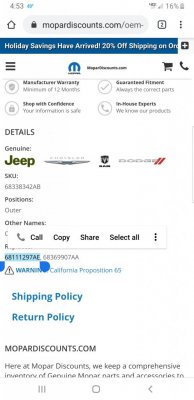

I just confirmed with one dealer that under my vin which is a 2018 your part is correct he said but the old parts photo showed the the old one with the two nuts and adjuster sleeve. Also said he could get it for me. Going to order that and two nuts tonight. Let me know how the install goes and the torque specs you are using please. Again I really appreciate your help you made things way easier and a hell of alot cheaper and stress free to hell with FCA lol do it myself.

So this may help people further from what I have learned on here and today. I ordered my part and was assured I could get mine like the other members have. I ordered mine from a dealer online and not the place in this screenshot I will add. Not saying you cant get it from this place the part number is correct. So you will notice in the diagram that it still has the old style with the adjuster sleeve, two nuts but yet the part number is new. Now the bottom it replaces two old part numbers the one highlighted is what is currently on my truck. Next you will see what Maligator posted of his part with the the correct number clamp style. Mopar must not have updated the pics but the part is correct with my vin 2018. Some dealers are saying its impossible to get this unless it goes through a dealer and a STAR claim. Must be the solution to the problem. I say order it obviously members have gotten the FIX TO V06 in the mail.
