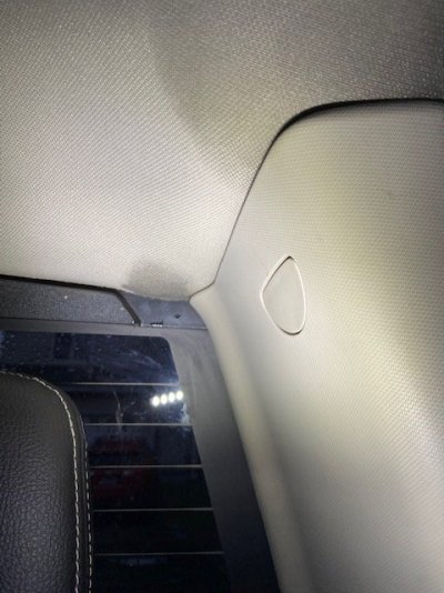

Hello Everyone,
New to this forum and dealing with what seems to be a common issue and that is my 2017 1500 is leaking. I have already installed new 3rd brake light seal with some md waterseal from Lowe's that I have found works well from watching video's. Before I did that the headliner was wet all the way across the back window. I installed the new gasket and thought I was in the clear. Then it rained heavily throughout the night and when I was loading up daughter to take to daycare I noticed water on the rear driver side seat. Did some close examining and noticed water at the very corner of the headliner and it was soaking around the pillar. I attached some pics as well. There has also been water dripping from the ceiling speaker as well. With the 3rd brake light issue addressed (or so I think) I am leaning towards the sharkfin antenna may be the culprit or the outside seal that runs on the exterior of the cab. I am trying to find a good video or DIY on diagnosing this as the issue and what remedies there are if that is indeed the cause. Does anyone have any pointers, advise or suggestions on this?

If you're confident the 3rd brake light is sealed then I'd concentrate on the roof mounted antenna next. I've also heard of the roof seam leaking as well, although that's not nearly as common as the brake light, antenna or the rear sliding window
Atcer2018
Aug 10, 2019
1,488
2,506
Virginia
3.6
Looks like a 3rd brake light leak. Possible your repair didn’t fix the problem? Could be the GPS antenna. Depending on where your shark fin is located determines what part of the headliner you’ll need to loosen to get at it. Mine is in the front driver side area so not too difficult to get at. YouTube is your friend finding vids how to loosen the headliner. You won’t need to completely remove it, only loosen it so you can get your hand up inside and a 10mm socket or wrench. Two electrical connections to disconnect and one 10mm nut on the antenna and it pulls up and out of the cab body. Make note of how the base plate pieces connect together. Clean the bottom with alcohol and use 3/16 self stick weatherstrip from the hardware store. The closed cell foam waterproof stuff is best. Apply clear silicone caulk on the underside of the inside edge on the antenna. Carefully reinstall into the cab roof and tighten it back down. Give it a few hours and spray it down with water to make sure it’s not leaking before reassembling.

Don't know about the Sat antenna but the 3rd brake light issue was addressed with an improved gasket, several years ago I believe.
Mine seems to have the original, as it is pretty thin, although it has never leaked despite my frequent R & R. Yours would already have it, so it has been addressed.

Mine did this. Replace the third brake light gasket. I also added some sealant to it as well.
