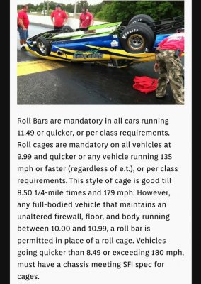

Cage would be 11.99 and faster
Cage isn't needed on anything newer then 2008 till you hit 9.99 these days.Loop isn't required at most tracks till 11.99 as long as you're on street tires or drag radials,if you're on slicks it's usually required at 12.99.Master disconnect switch is required if the battery has been relocated at all speeds though.My truck is set-up to pass tech anywhere,as i'll run the bracket circle in the summer which encompasses 7 differant tracks,and there is one track that's sticky as far as rules go,they're the only track who've ever checked to see if i do have a loop,they're also the only track that won't allow 4X4's as they've had a couple hi-po 4X4 diesals,bend the steering linkage on launch,and take out the tree,so they've since banned 4x4's.
Thanks. I was puzzled till I found it was specific to cars. I've only drag raced my cars and use my truck to get them there.
Wrong page of the book.Read a little more on the late model classes,anything after 08 doesn't need a cage or rollbar till 9.99.Otherwise they wouldn't be allowing any of the newer toys that run deep into the 10's off the showroom floor to run,like the Hellcats/Red Eyes etc. Look in stock and street legal rules
Ahhhhh.....shows how long I've been away. Guess I can flush all the old rules out of my memory and learn fresh. Thank you for the info!
