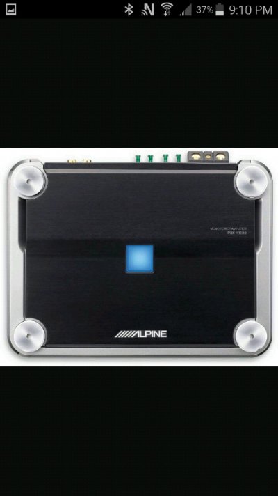

Yes, the PDX are great amps. I think the price is kind of high for an old generation PDX though.

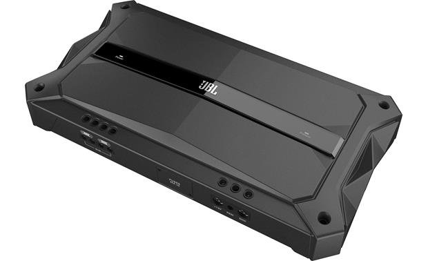

Two dual 4 subs only run at 1 or 4 ohms. Can you get a picture of the back of them? the JBL is a decent amp, I have installed the 550 but not the 1000. The 550 does not have a bass knob input, check the 1000 is you want one.

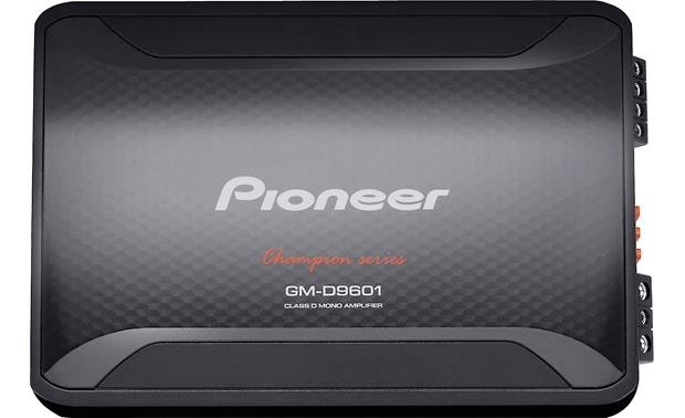

nice. Sonic seems to be cheaper on everything compared to Crutchfield. Thanks! would you take the Rockford over the Pioneer though?

ok guys thanks so much. I think i'll go with that Pioneer amp and an LOC which looks like it's not that difficult to install. I'll let you know how it all goes! :)
