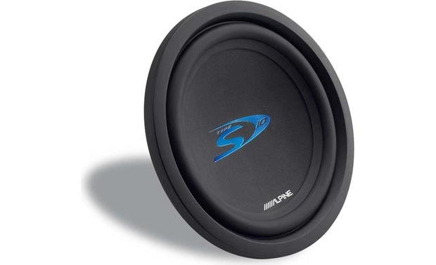

I looked it up on alpines site. The type S 10" is 500rms 1500 peak capacity. Should be ok, but i'd turn the gain down a touch more than usual to be safe. I'm guessing they're dual 4ohm voice coils wired to 2ohms each.

so it looks like the older model Type S is only 300 watts RMS. hopefully I don't blow them up....lol

It was all about how you treat it. Don't clip it and it will take more than rated, box size is also a consideration. The smaller the box, the more power it can handle. Also how you play it, heat kills speakers, so if you are jamming on it non stop, it will take a toll.

I agree with a few exceptions...I do not like relying on 1ohm power...if an amp is "underpowered"in 4ohm applications, but I can get that extra power in 1ohm...I will go with a higher powered amp @ 4ohms versus relying on 1ohm power. Some amps are 1ohm stable but it adds extra stress and heat to the amp which is never good. I like keeping all equipment comfortable. Amps get hot and I get that...but it may be my conservative nature. I am all about overhead power. Im running 365 watts to my 100 watt rated midbass...but its at 40hms, there's zero distortion, and my midbass speakers are always happy and never uncomfortable. Sub frequencies are very dynamic, can hit very hard with gobs of power outta no where...I personally would try to keep the amp load @ 4ohms for those type S subs....300-500 watts will make those subs pound (i have owned type S 12's in the past....gave them 300 watts each with great success)
