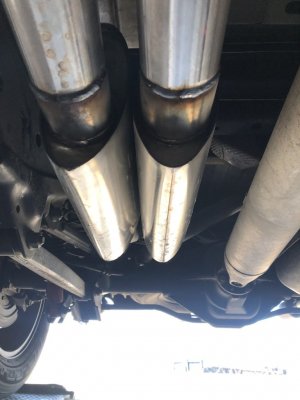

C623F21A-13D1-4179-B6F4-83C5E1FB18FE.jpeg 14B46008-9A17-4414-8A70-B7ABEBACFD50.jpeg Here are couple pics
They didn’t install it all to my preferences but when I add my cutouts I will move the x pipe forward a bit.

Nice clean job.
Don't you usually want the X or H pipe installed as close to the engine as space will allow?

Mesa
When I saw what they did I said whatever. I bought a cheap welder and my cutouts. I’ll be moving it forward and installing cutouts after just before the mufflers.
