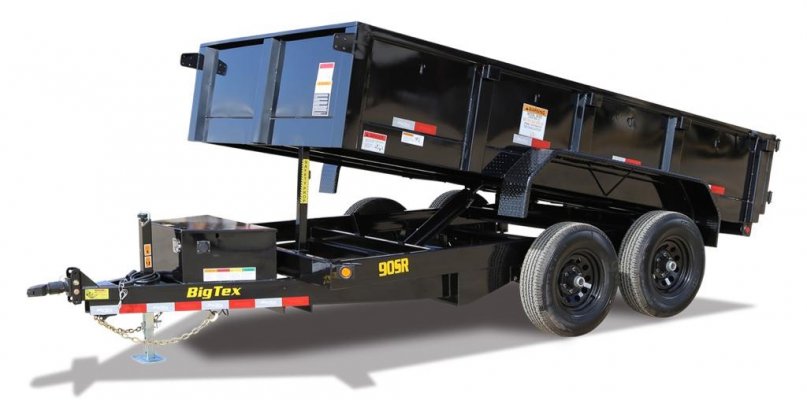

Anyone have any experience with a quality dump trailer? Curious to hear some real world feed back. I am looking at getting into junk/ trash removal.
Considering this one:
https://www.bigtextrailers.com/90sr-tandem-axle-single-ram-dump
How do you think my truck will do? Seems like an HD will be on the horizon maybe. 2014 Ram 1500 8 speed 5.7 3.92 max tow package.

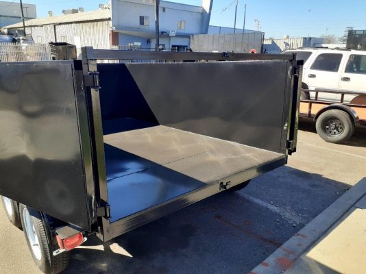

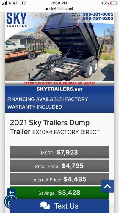

I found this company about an hour from my house. They have a 8x10x4 (a hair under 12 cubic yards) with dual 3,5000lbs axels and two year warranty. Not too many specs on the website but I am considering calling and talking to a sales rep.
Here is a link to the site:
https://www.skytrailers.net/vdp/137...X4-FACTORY-DIRECT-for-sale-in-Colton-CA-92324
Also, from Ram, my trucks payload (1450lbs)/ towing (10,000lbs) numbers:
https://www.ramtruck.ca/en_dir/pdf/towing_1500.pdf
Unfortunately, I think I have to call for trailer specs because I cannot find them on the site.
I think the price is good. It is very entry level and hoping to expand from here. A more heavy duty larger truck and trailer would be sweet. But, I am going to use my 1/2 ton to get things going with smaller residential jobs. I will need a more purposeful set up to land professional jobs with the big boys. I hoping that is on the horizon for me.
Some more photos:

For a dump any larger than this it really should have dual hydraulic cylinders.Looks like a good price no doubt

My buddy has the Bigtex 90sr tandem and loves it. He's in construction/renovation and (over)loads the hell out of it regularly. He pulls it with an HD truck, which handles the loaded trailer very well, including dragging it off muddy job sites.

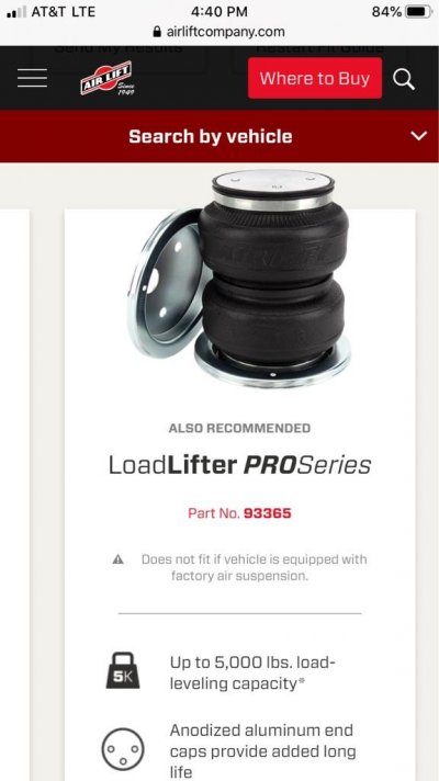

I am thinking of adding this to my truck:
https://www.airliftcompany.com/shop/93365/
Obviously my truck’s factory tow/ payload ratings still apply and are not changed. This just helps alleviate some squat and might improve ride a bit while working. Especially since some of my payload is effected by my LEER shell. Opinions? Thoughts? Thank you.
