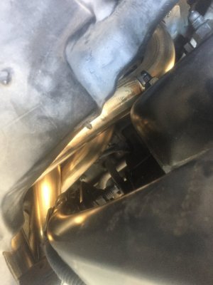

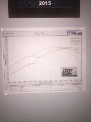

2014 crew cab sport. 4x4 20x12 wheels with street tires. Of course the 8speed with 3.21 gears.
Mods:
Stock throttle body
Vararam intake
ARH 1 3/4 cattless long tubes
Magnaflow direct replacement 18” muffler
Custom dyno tune using CMR software with my diablosport I3 tuner by Brent Hughes of DTP Racing in Chesapeake Va.
90 degrees and humid today. Dynoed with 20x12 wheels as well
Results:
374.2rwhp
380.6rwtq
Sounds good. Runs good. Can’t wait for cooler weather.
Next may be fan delete and 180 thermostat.
Opinions, suggestions etc welcomed as are track tips. Going to run 1/8th this weekend.

Nice numbers! Can you post a pic of the dyno graph?
