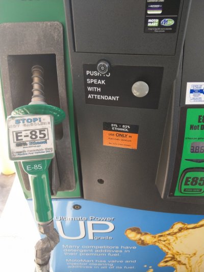

So I noticed today that for whatever reason the E85 price isn't going up. It's still $3.85 and regular is up to $5.09. I decided to give it another tank before making a final verdict. One thing I noticed on the E85 I hadn't noticed before is the large variance in ethanol disclaimer on the pump? 51%-83% ethanol to be considered E85?
