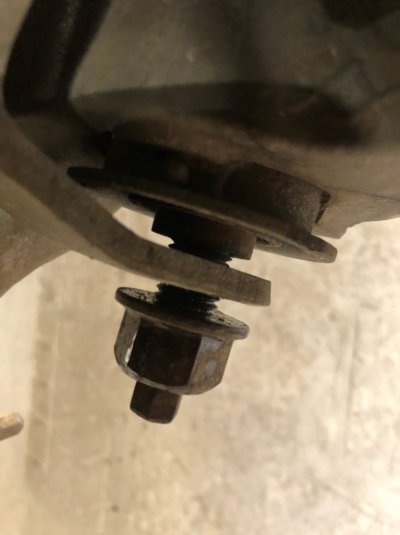

Started on the driver’s side to find out that the previous owner didn’t really pay attention when he installed the struts:
-Bottom strut bolt on drivers side with roughly 1/8” thread still showing between the but and strut body [emoji15]

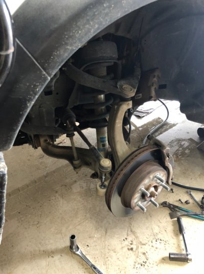

-out with the old... Buddy of mine lent me his F150, to make sure I could make trips back and forth till I got finished. Had to put the ‘Stang outside to make room in the garage.

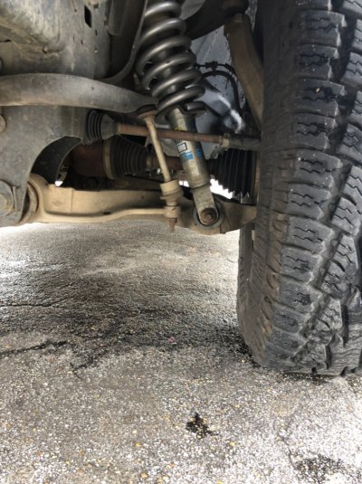

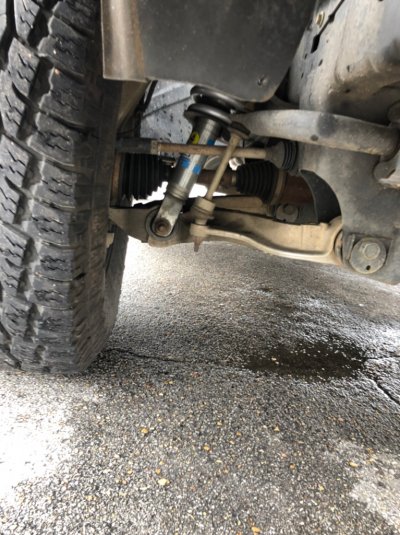

Obligatory CV/control arm angle pics - it’s been raining here, not a leaking truck, lol.
Weak strut/shock for the difference L/R??? What do you guys think?
