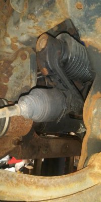

I NEED HELP! I’m not sure how to post on these forums. But I have a 03 Dodge Ram with 5” pro comp lift and do not know where to get this part connected to steering rack and tie rod.
Call up pro comp and see if they still make the lift or parts for the lift. Or possibly try to have one fabbed? It looks like a “ Drop bracket” of sorts.

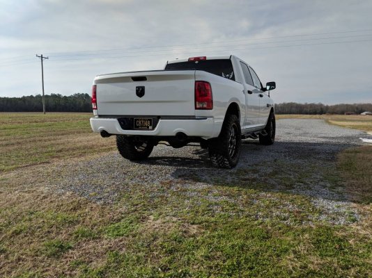

Looks good. You’ve convinced me to get a full set of springs and rear shocks. They should work great with my Bilsteins. Thanks for sharing so far, and I hope to see additional updates on ride feedback and any issues and such.

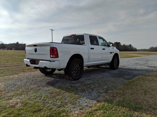

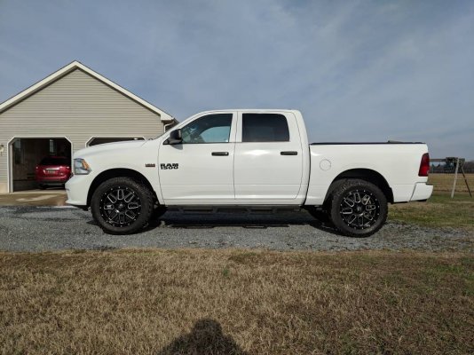

Man that looks good!! How does it ride compared to stock? That is just with the front at 2.75 and the rear at 1 inch, correct?

What are the fender measurements ? This is now the 2nd time i've seeing this springs set at 0" on a crew cab and they don't appear to be giving 2.75" lift, that's more likely 2-2.25"?, and given this pictures i'd think the Eibach springs with the Billies or Eibach struts set at the 0.7 perch should provide the same lift as billies set at 2.8". This setup should ride a lot better than Bilsteins at max height because the springs are not fully preloaded like factory ones would. I like how it sits because there is still some rear rake so if you load up the bed it doesn't look like you have a Cali bro lean :)
My prediction for fender measurements, 39" front, 41" back, but i'd wait for you to post your numbers.
Thanks!
Thanks! Yes this is the front at 2.75" and 1" in the rear. It feels a little firmer than stock. I like them so far.
You are spot on the fender measurements. I'm 39.5 in front and 41.5 in the rear. The rear should settle some too.
Ok thank you! The lift was on from previous owner, my mechanic is not sure about it but he knows it needs replaceing since it is loose and movement from tire. Tie rod still seems ok. A drop bracket was exactly what I figured As well

Thanks!Thanks! Yes this is the front at 2.75" and 1" in the rear. It feels a little firmer than stock. I like them so far.You are spot on the fender measurements. I'm 39.5 in front and 41.5 in the rear. The rear should settle some too.
Did you measure from the center of your wheel to the bottom of the fender? Thats the preferred way to do it. That way no one gets confused.
