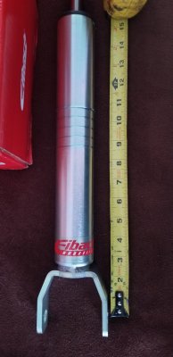

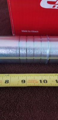

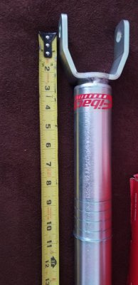

Although, now that I think about it....I could not find a part # for the spring perch thing that the coil rests on. Does anyone know if I need that or if the profit comes with a perch installed already?
If I do need it, does anyone have a part #?
