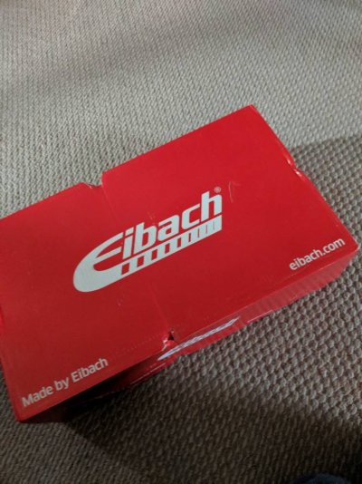

Which parts are those?
Looks like a set of springs box.
hodge-xj
Jun 7, 2013
2,802
2,354
5.9 cummins
It's the rear springs. Also got the rear shocks.
Awesome!!! Glad that you actually got all the pieces! Anxious to hear and see how they turn out!!
