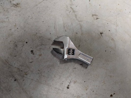

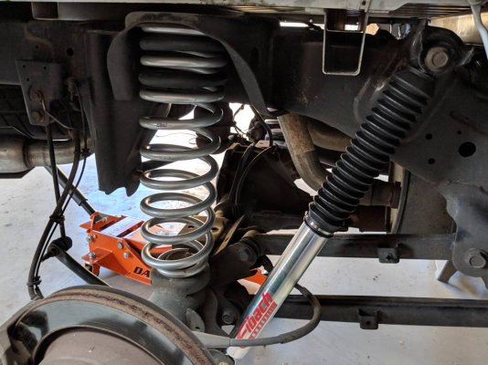

Got the rear shocks and springs installed. Went super easy. The trickiest part was getting the top bolts off the shocks. That's what the cut wrench was for. I seen that tip on YouTube. I really had to work to get the springs in since they were longer than stock but wasn't too bad. They measure about 1.5 in higher than I was stock but I think they will settle in right at the advertised 1 inch. ea429fb713f6366b090419cf11dd40f6.jpg0983f2fef75dbc2dac2b4a4417a2e363.jpg0cced5c888c9524b0aa1c8a201c7bae0.jpg

Looking Good! Gotta be the one to ask.....HOWS THE RIDE [emoji16]

Wish I seen em sooner lol. The $4 wrench from harbor freight worked well.
