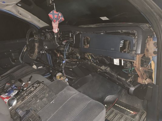

Thanks! I actually got around to doing that finally. I tore my dash apart couple nights ago and found a ground wire, well wires, it was several wires attached to one connector but it was just dangling back there arching on the frame of the dash. Screwed it back to the frame of the dash and it fixed a lot more than just my original problem. My 3rd brake light works now which it never before. My dome lights are a lot brighter some now also.
But thanks for the tip and I hope this’ll help someone in the future.
