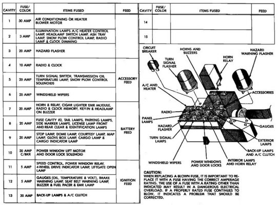

This will sound stupid, I was under the dash of my 1993 1-ton Cummins, and when I got up the emergency flasher unit was on the floor. I can't find where it plugs in :(. Can someone help me? Picture? Color of wires? Location under the dash? Thanks! Signed: "feeling stupid"

Thanks, I even had that fuse panel out, trying to find the location for it. Obviously I missed it, probably too obvious! Thanks!
