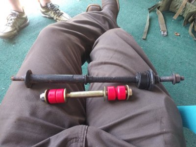

Has anyone here upgraded to energy front sway bar bushings?
I measured my stock ones, ID seems to be 1/2". But they could be worn out.
Steel washer hole is 3/8".
OD is 1.5"
Anyone have a part number?

I did these to my 11 crew cab. They helped tighten up the steering
Energy Suspension 9.8103R END LINK GROMMETS https://www.amazon.com/dp/B004ALM99A/ref=cm_sw_r_em_apa_i_6-YkDbX98J3KT
Thanks. I ended up getting a stock replacement set at advance auto for cost. $21.84
I still have to grind, and bevel the "too small diameter" rough country 3/8" sway bar end links and tig weld these on.
Grunt fab sway bar end links will have 1/2" threaded sway bar end links, with energy suspension bushings, and be quik disconnect.
No way in hell I would supply 3/8" steel rod end links with any of my kits.
As a matter of fact, I am calling tomorrow to get pricing on 1/2" chromoly to fab sway bar end links.
