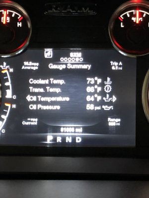

I couldn't find other posts in regards to this. I was curious if this is a thing for all later model Rams. Per the dash readout on my 2017 Ram express 1500, pentastar QC 4x4, the transmission fluid temperature will read close to the ambient temp on cold starts, but the engine coolant and oil temps won't show below 100F? I wonder what the reasoning is behind that? If it's 20F out on a cold start, my transmission fluid temp will show maybe ~30F. Everything else will be 100F.

I have a 2014 with the 7” EVIC and it shows me the actual temperatures. I can see the oil and coolant being close to the outside air temperature when I start the truck. It will even show me the negative numbers.
