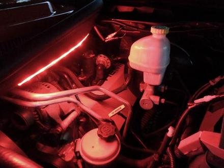

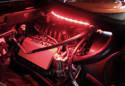

That looks nice. Any reason this couldn’t be tapped into existing pressure/latch switch rather than using the rocker switch in the kit?
You should be able to tap off the hot lead in the loom going to the existing hood light, then just ground anywhere convenient and eliminate the switch & wiring. I'd run both light hot leads to a common wire with an inline fuse.
