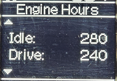

Sorry if this has been covered before. I saw some threads but no real resolution.
This is on my 2017 Ram 1500, pentastar, QC 4x4 express model. Just over 40K miles on the ODO. I just noticed yesterday when toggling though the dash display that my engine hours were reading 16 drive time and 165 idle hours! It's been awhile since I checked it, but last time I looked I believe I was approaching 2000 drive time hours and about 200 idle.
Truck is all factory yet. Haven't had any issues. I'm sure the PCM stores the real numbers, so maybe the dash reading zeros out somewhere around 2000hrs drive time hours?
Why the idle hours didn't zero out like the drive time is really weird. At a loss with this one.

From a quick search. looks like this just happens sometimes. I saw your post on Bob the Oil Guy too. Like you said, probably just the instrument module not reading right, not the PCM. If under warranty still, take it in and see if they can replace it?

Add me to the list. My drive hours reset to zero also. Previously had about 1300 and change for drive hours. Nothing happen to indicate why it did it. Just went over 3 years on the 3/36 warranty and nothing I am willing to pay for to troubleshoot so I will just live with it.

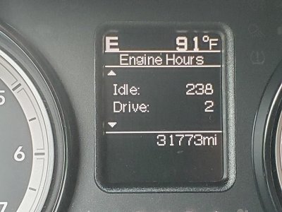

Does anyone know if there's any way to find out THE ACTUAL numbers for IDLE hours and/or DRIVE hours...? The dealer, of course, said the PCM on my truck read the same as the dash - so IT'S NOT A MODULE ISSUE. He followed up with: "...those must be the numbers..." - never mind the fact that it's showing 264 DRIVE hours in 84,600 miles... mensa...

Bump for same question. I just ordered a 7" EVIC to upgrade my 2017 Ram's 3.5" EVIC and while sitting in my truck decided to look at my idle and drive hours since I will have to record them when I'm ready to swap. Well it says 885 idle hours or something close to that and 185 drive hours. It's the original EVIC and I've not messed with instrument cluster settings in Alfobd. So is there a way to pull correct numbers with alfaobd?

Get actual engine Run/Idle hours
1) Cheapo OBD reader
2) Torque Pro ap - https://play.google.com/store/apps/details?id=org.prowl.torque&hl=en_US
3) download free extended PIDs csv - https://drive.google.com/file/d/18CkJlaNAK3kr7jWknm3JzSOXp59bwoM4/view
4) add the extended PIDs in Torque Pro
a) open setting (gear) from main page
b) manage extra PIDs/Sensors
c) 3 dots - import CSV file
or if you have something else and can manually input PID info
My post on this https://www.ramforum.com/threads/true-engine-run-idle-hours-via-torque-pro-and-extended-pids.210015/
