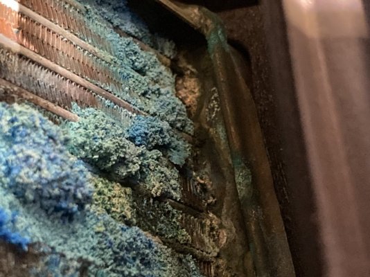

I recently replaced the original heater core:
What a task! But now the heater/defroster is working.

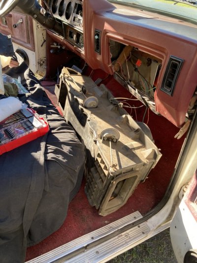

it felt like under and behind. It was not very much fun. While it was being replaced, I cleaned out 5 lbs of sticks, leaves, and dirt.
