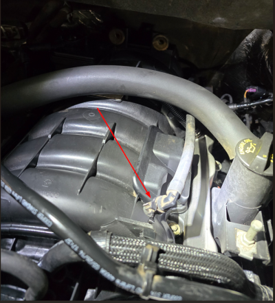

Just replaced my 5.7L with a new zero mile hemi from Benny @AllMoparParts.com. Have everything ready with the exception of one hose. Can anyone tell me what to connect this one to? I may even have it on the wrong side of the engine.
thanks in advance!
thanks in advance!
It doesn't connect to anything,it's the transmission breather tube,it just lays right where you have it,as Daw stated

Transmission or front diff breather, attach as high as you can get it.

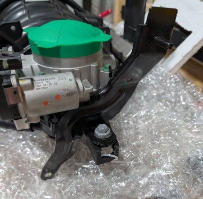

One last mystery item. Any ideas where this bracket belongs?

I was going but the large hole , could it be from the engine cover , as part of attaching it?

Did you get all the brackets bolted back onto the bellhousing,as i seem to remember one like that,that bolts to the bellhousing and holds some of the transmissions wiring

This picture is courtesy of @16WhiteQC from his 6.4 manifold swap thread.There's a bracket on the front of the 5th Gen intakes ,that looks like your bracket.
