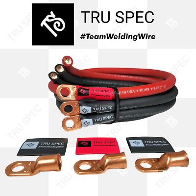

You need 10 feet of wire. You will have some left over depending on how short you cut it. I leave mine a bit long.
I get the wire from a welding supply store or off ebay. Get OFC copper wire not copper clad aluminum wire. The difference is obviously the price. You will need copper end links and a way to permanently connect them to the wire. I use a BAH (big a$$ hammer). I then solder the end links after they are connected by filling any gaps with solder.
3 wires, 6 copper terminals, hole size 3/8s. I usually buy 10 in case I mess up.
Negative battery terminal to fender wire, wire is approximately 15 inches long.
Alternator hot post to positive battery terminal wire is approximately 3.5 feet long.
Alternator anchor bolt to passenger fender. Wire is approximately 5 feet long, unless you want it laying on your intake. I run it straight back to the firewall and use zip ties to take it over to passenger fender.
I have done 2 with 1/0 cable. It's overkill and have done 2 with 2 gauge which is cheaper and just as good. The wire will never see the load it could take so why over buy.
My supercharged RT got a 4th wire from the fuse box (TIPM) to the battery, just because and it's considered then a big 4 upgrade.
Since the RT goes to the track and sees severe duty, that's why I did the 4th wire.
I hope this helps. Ebay link
My supercharged RT got a 4th wire from the fuse box (TIPM) to the battery, just because and it's consider then a big 4 upgrade.
Dude this is perfect. Let me get on this ASAP. Can’t thank you enough for all the details.

If you look on ebay they have big 3 kits, that come with pre cut wire. And 3 of the wires with the copper ends attached and 3 that are loose. Alot of people go that direction and it's perfect for them. My first go at this was with a kit. I just didn't want the wire laying on the intake, so I ended up sourcing extra cable. Truly your call on what you do.
It's a wonderful upgrade and it solved some of my weird 8.4 radio problems.
Good luck

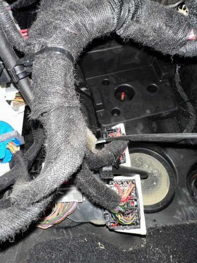

NOT THE Parking brake module unit on the left side, the connectors against the firewall, drivers well, to the right of the BCM, check those Connectors!!!
Those are the one that were some issues on the II Gen ED's, a lot were not connected fully and there was some reports of water issues, but that was long time ago,
check those for proper connection and any water issues (be careful, them wires can be fragile).

NOT THE BCM on the left side, the connectors against the firewall, drivers well, to the right of the BCM, check those Connectors!!!
View attachment 564382View attachment 564383
Gotcha. I’ll get back out there during my son’s nap time and take a closer look at these specific areas. Thank you!
