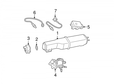

I did find a diagram of the evap canister and purge valve. My gut is telling me this is near the fuel tank not in the engine bay. Sigh.... I will drive on it for a while and hope the light goes out. that or when my code reader gets here see what code it is throwing.

It will take a long time for the light to go out for a evap fault, may take a few weeks, if that was the issue.
The ESIM is a more likely fault. It is attached to the canister, facing rear wards. It’s #3 on the diagram posted above. Make sure to change the o ring as well, if you change it.
The purge valve is located near the TIPM. You can always follow the vacuum hose on the intake manifold to the purge valve.
