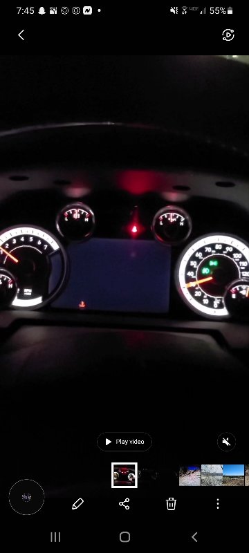

So this just started yesterday, While driving my dash and evic just turn off and restart. Sometimes it stays off for minuets before trying to turn back on. I have already looked at the fuses and made sure they are pushed in and I have checked the grounds. Everything else on the truck still works like the cruise and blinkers, lights, radio....everything except for the instrument cluster(evic).
The vehicle is a 2014 Power Wagon with 120k on it.(so no warranty) has anyone else had this problem and if so what was the solution? The attached pictures are from the video I recorded this morning. 1d0a6d183f8faa2d512eed121944a363.jpg77d619c08e90c51e979a3355319c96ce.jpg8c911c29561d13ef524eaf8226d64371.jpg

Loose connector on the back maybe? If not that, then I'd suspect a flaw in the evic itself given that you've already checked fuses and grounds. Do you have an extended warranty in effect?

Unfortunately no that just expired as well in September

Probably your best bet is to search car-parts.com for a used one. Should be able to find 2014-16 for around $200. Then you'll have to get alfaobd ($50) Google play store and obdlink mx (~$80) Amazon to reprogram the mileage and hours.
