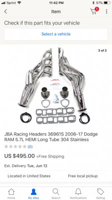

When i decide to fix my bolts, I will be installing these. They are not 309, but 304 stainless. They will develop a little surface rust, but you cant see them anyway. Ceramic coating doesnt hold up to winter salt anyway on every day driving.
