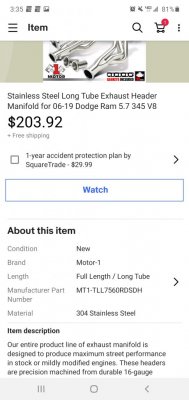

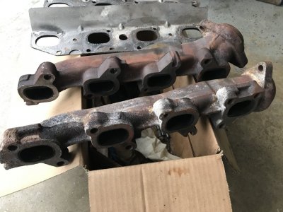

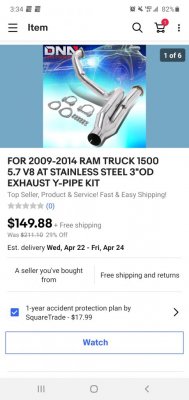

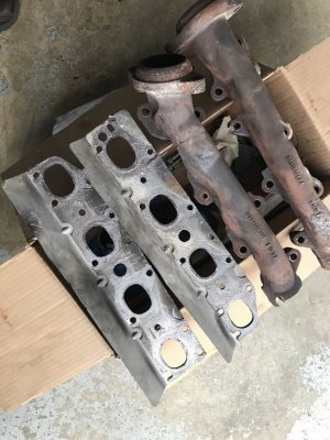

So...from ebay...at 25% of the cost of the top brand names what do I have to lose but install time...see pics
