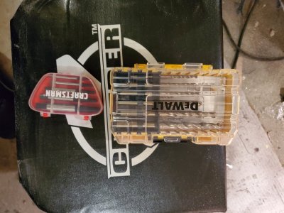

Check you kustomblack motorsports on you tube and also lukes garage on a lot of ideas and advise on how to do it...if you have broken bolts my advise is using a center punch, 90 degree angle attachment with left handed drill bits and it that doesn't work use Dewalt drill bits with a craftsman extractor set...I ended up using the extractor set myself...see pics
