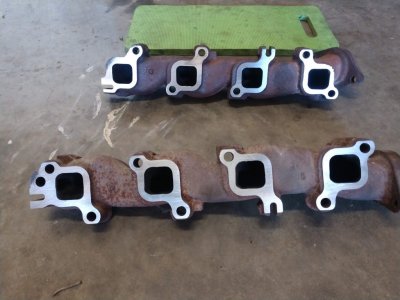

I pull these manifolds off on damn near a daily basis on my customers trucks and run them on my large belt sander or my mill to clean them up. My local machine shop only charges a flat fee of $50.00 to clean up a set of manifolds if I don't have the time to get to them.

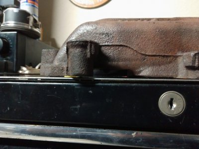

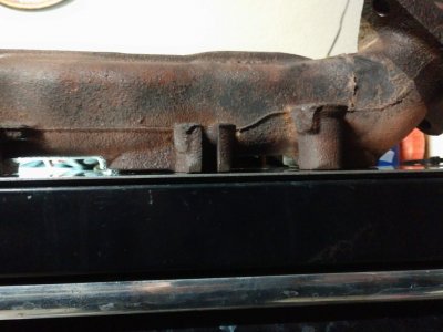

I see warped 5.7 HEMI exhaust manifolds all the time. Here are a few pics of the last set I milled from a 2004 DR that I bought. As you can see in the pics one of the ports on the end is flat and the other end of one manifold has an 1/8" gap showing light and the other had a 3/16" gap.IMG_20191109_005611159.jpg

I see warped 5.7 HEMI exhaust manifolds all the time. Here are a few pics of the last set I milled from a 2004 DR that I bought. As you can see in the pics one of the ports on the end is flat and the other end of one manifold has an 1/8" gap showing light and the other had a 3/16" gap.View attachment 191584

At my dealership in Texas we repair broken exhaust manifold bolts and warped manifolds on a regular basis. I started repairing broken bolts on 5.7 HEMI's back in 2005-2006. I didn't start belt sanding the manifolds in the dealership until 2008.
One thing that drives me crazy is all the HEMI trucks that live on my street have broken bolts and exhaust leaks. That is one of my pet peeves. I despise exhaust leaks. I hear my neighbor fire his up and it makes me crazy. Last year I got worn out on repairing broken bolts at the shop so I had to teach a young mechanic how to do it so I could take a break.
When I am working from my own shop at home I do at least 2 trucks per weeks with broken bolts. So far I have never had one that has been repaired come back with a leak or a broken bolt after the manifolds have been resurfaced.

The exhaust manifolds are relatively flat when when new. Most measure in the .001"-.002" range from end to end which is in spec. I have had several with a .008" - .011" difference from end to end when they were new out of the box. Those were the worst case scenarios. I actually ran them on the belt sander before installation so I wouldn't have a damn recheck even though I didn't get paid to correct a new part. It's just part of being a tech.
I talked to my zone tech back in 2008 about the warped manifolds and broken bolts on so many of the HEMI trucks. In my opinion they are a poor design. They have zero as-cast rigidity or support webbing to strengthen the material and my zone tech agreed. We had a rash of warranty claims that Chrysler didn't want to pay until our zone tech and the zone warranty administrator inspected the manifolds that were being returned under warranty. Our parts department had a 4'x4'x4' box on a pallet full of exhaust manifolds waiting to be returned. Once the 3rd Gen trucks began to fade out of warranty and the 4th Gen trucks were getting some age and miles under their belts we started all over again with broken bolts and warped manifolds.
Around early 2014 we started seeing the same thing all over again but this time it was worse.
Once the exhaust manifolds become warped and the material has moved it is normally at a point where any more warpage would be so minimal that the gaskets take up the slack to prevent leaks. We have some techs in our shop who after extracting the broken bolts reinstalled the warped manifolds with new gaskets only to have them break the new bolts withing a few hundred miles. If you looked at my pics you can see how much of a gap there is from end to end. The bolts can only take so much torque when attempting to clamp down a manifold.
