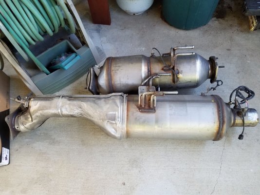

If it hasn't been modified, your system has what passes for a muffler which is a dual purpose cannister.
My system had a close coupled catalys at the down pipe, a diesel oxidation catalyst cannister (DOC) and a combo DEF chamber & muffler cannister which doesn't really look like a muffler. In this pic, the top can is the DOC, the bottom can is the dual purpose cannister:
The delete removed both of those cans and I installed a Corsa dB Series muffler.
If you plan on removing either or both of these cans it is a delete. If you just want to replace the tailpipe no delete is required.
