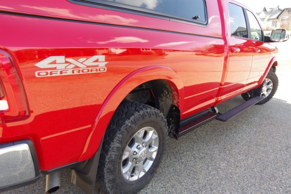

Dean2
Jun 17, 2021
4,387
8,750
Near Edmonton
2021 2500
If your truck says Off Road on the side it is not a dealer installed option, it came that way from the factory. My 2021 I ordered with the off road package as it comes with Bilstein Shocks, and they ride much better than the standard factory ones. Ride height is 1" difference. If the height is an issue have them install Mopar Power Running boards. Makes getting in and out a breeze and about the same price as changing it to get it 1" lower.
