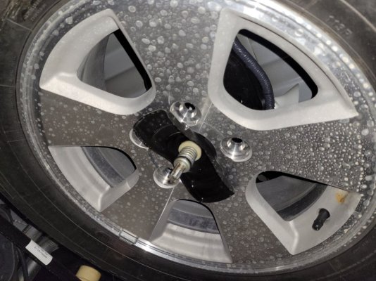

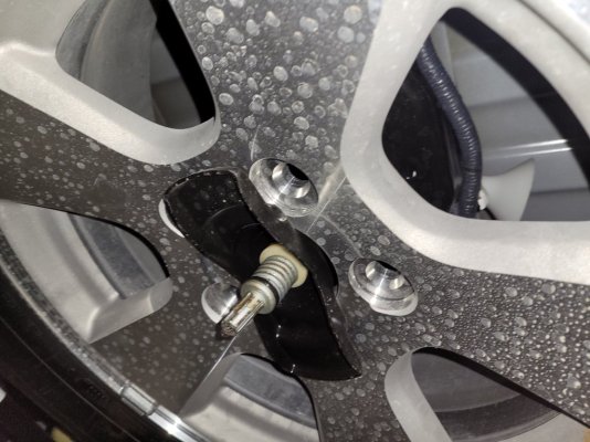

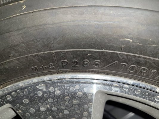

I got curious about this in regards to my new 2024 4th gen warlock classic. When I ordered the truck I made certain to click the box called full size spare.
I crawled under it today as I was changing out the side swaybar standards, from stock to some roadmaster ones and well. The full size spare is a standard ram 17 inch aluminum wheel with a full size 265/70/17 Goodyear wrangler mounted on it. This wheel if I dropped it would have the small center hole and accept the round disc with the rams head on it.
Now, I did not investigate further but, it appears there is some way to mount a regular wheel to the spare tire carrier cable or I've got a spare that can never be unmounted.
I'm not curious enough to take the wheel down however i did take pics.
Fyi
You might want to drop that spare wheel at least once to make certain the assembly is functional before you need it unless you have an unbelievable roadside service.
I live in a rural area, nobody is coming too quickly to rescue me. :cool:
The full sized spare with my '21 Warlock has been shrunk to a 235/85/17 on a steel wheel.
I have yet to determine if a real full-sized tire can be fit up there and if the carrier bracket can be fit through an OEM rim.

I agree, i live in Montana, if you can't do it yourself its not gonna get done, however they got it up there somehow, I'll bet they would not have sold it without a way to use it. I don't think Ram is that incompetent. This is on a 4th Gen 2024 Warlock.
