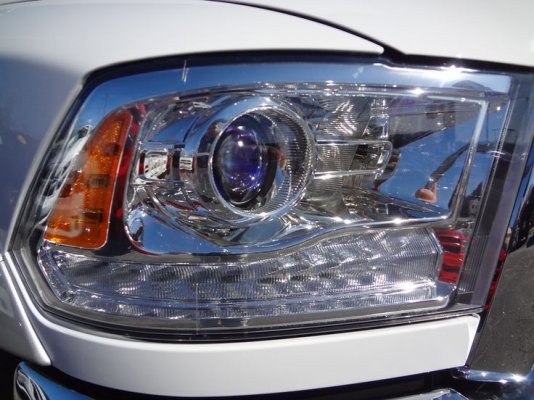

One last question I find a lot of different part numbers for these lights some say w/projectors headlamps w/o sport. And others w/projectors headlights w/sport. What's the difference.
Revo
Aug 16, 2014
404
85
Canada
5.7L
There's two types of projectors, they vary by the color painted inside. One has some pieces painted black (sport), the other is made up of mostly chrome (non sport). For the 2015s I believe they added a bit of a darker tint to the sport projectors. I'm not certain, but when I was at the dealer today I found that they looked darker than the ones on my 2014.
Sport projectors:
Non sport projectors:
brandonjansen
Feb 14, 2013
1,701
1,020
Abbotsford, BC, Canada
2012 Ram 3500 Laramie Limited
6.7 Cummins - Tuned and Deleted
They made the projector housing black rather than chrome on the '15 sport projectors. That's the difference you're seeing.
