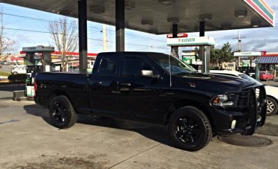

Wanted to update/close this gripe, they took my truck to a body shop and rubbed it down with cleaning solivent and waxed it. Took a good look around, it looked so much better. It's frustrating it took almost 5 months to make it right, but I am happy with the way it looks now. I even got starred at and got thumbs up driving around, some guy came up to me complimenting me on the paint, didn't believe me that it was the factory paint.
