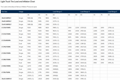

What's the front Axle weight on your truck? At 5,000 lbs the RCTIP would be in the 40 PSIG range for a 35x12.5R17.
https://tirepsi.com/35x12-50r17-tire-pressure
Similar data from Falken's site:
https://www.falkentire.com/tires/care-safety-warranty
Again, I believe the Ram door sticker is based upon worst-case load requirements. For example, at max payload on the truck plus max trailer weight it would load up the tractor axles differently than your specific use. They only get one pressure to put on the sticker and most users don't employ an OBA strategy where they adapt pressures to their load. So the paradigm is inflate for max load and live with it for lighter loads. Reduced traction footprint and rougher ride is the consequence of a one-size-fits-all tire pressure strategy.
The biggest risk to an OEM is tire blowout. That gets people killed and manufacturers in headlines. A la Ford Exploder from the early 2000s. Blowouts are typically due to excessive sidewall heat which is a result of under inflation. Therefore they post a number that minimizes court appearances rather than maximizes performance for your specific mission. For ideal pressures I would consult a chart showing the specific pressures for your axle load. I'm continuously adjusting tire pressures based upon traction needs, air temp, etc.
Though I'm all ears if emperical data or other logic indicates otherwise...

That might just be the most informative data about tire size/pressure/load.
I always found the 37'' run better at 35-40 lbs. Now I know it's right!

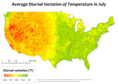

Yes, I use the live temperature pressure readout on the dash. Summers here we can have some diurnal temperature variations of 50 degree Fahrenheit. Normal variations are from 40 to 45. Can be 45F in the morning and 95 by late afternoon. I use the dash readout quite a bit on the road. Winter mornings can be below zero Fahrenheit and 40F by afternoon.

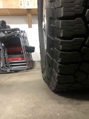

Alright gents, figured I would drop the pressure down just for ***** and giggles. At 50 front and 40 rear at the moment. Havnt drove the truck yet, but they still look surprising aired up to me.
3 pics below went from 60psi to 55psi to 50psi at the front of truck.

Very little change in deflection. Let us know how the ride is. If it's dry there you could also try the chalk method across the tread to see how far the actual contact patch is making it to the tread shoulder.

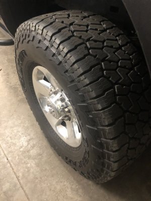

Since I started this post guess I will go ahead and provide an update on the tires. Have about 6,000 miles on them.
- Still ride smooth.....took very little weight to balance
- Good wet weather traction, winter is coming up so will see how they do as last winter we had very little snow or ice
- Passenger front tire started cupping pretty quick, and the tires got a lot noisier. Later found out the shock was bad (started leaking badly) which will cause the tires to cup and therefore get noisy. Have since replaced the front shocks and rotated the tires and they are wearing good now.
- You can still hear them on the freeway but not bad, actually toned back down after rotating and replacing the shocks. My super picky wife has never mentioned the tire noise, but also keep in mind the half worn Duratracs made noise too.
- Some rock/mud rash on the treads after play sessions.....was climbing muddy hills bouncing off the rev limiter with the truck barely moving but the speedo showing 25 mph.
