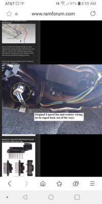

Love when someone else posts a problem you have too.
Out with the old, in with the new.
