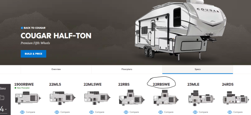

I'll concede that the 22RBSWE is a TT after digging into their links. I'm not sure why Keystone lists them that way.
That said, then the lightest fifth wheel they offer is a 23MLE:
Length: 27'11"
Gross Weight: 10,000 lbs
Wet hitch weight: 2,000 lbs
Better?
Now..... explain how any of the numbers I posted are crap? They're literally the numbers from the manufacturers and you can look them up AND do the math. The only thing I didn't do, which no one with 2 seconds of RV knowledge would do, is use their dry weights.

LOOK at the PIC.... It IS TT...
No wonder you keep posting wrong information. Learn how to use a computer.

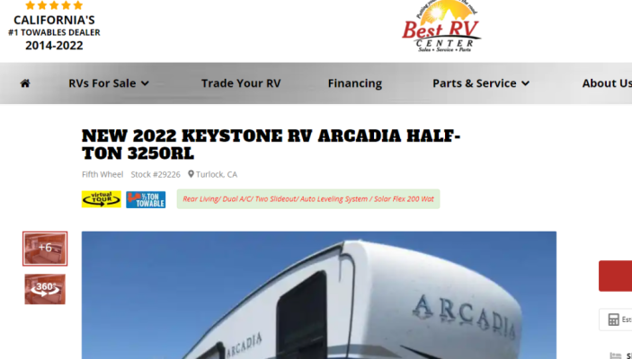

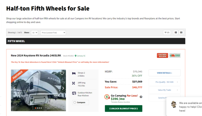

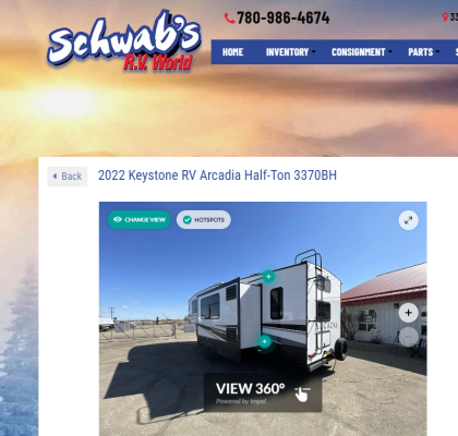

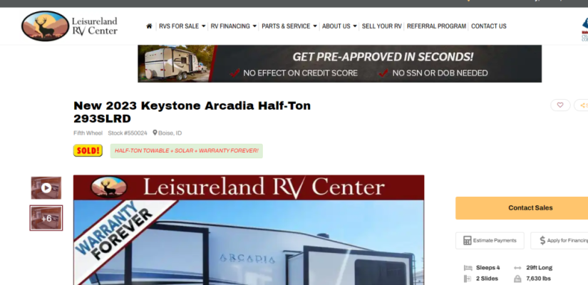

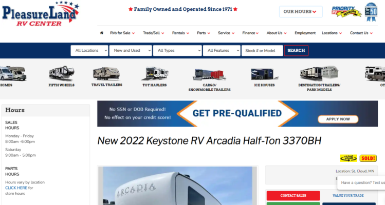

Yet, you still miss the point. They're being marketed as 1/2 ton trailers. I just showed you one example (Campers Inn). Here are a few more.
Now.... answer my other questions. Prove that my math was wrong.
