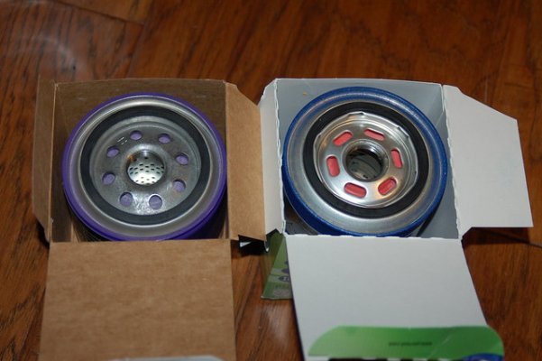

99% at 25 microns and wont blow a hole like paper and filter nothing at all. Compared to say Fram that is rated for 20 microns for all of their filters, same as Amsoil. So to answer your question Royal Purple filters great and I doubt you could get them to fail if you tried until they simply get clogged. And the flow rate is better then other filters and it made a difference in my own truck when I used a Purolator synthetic filter and my tick started coming back. The puro is also rated at 25 microns but as I found out does not have the same filter holes that allow flow as the RP does. See bottom pic, the RP filter has 8 holes but many smaller holes in the mesh body, and it makes a huge difference in oil flow. All I did was change my filter because I run my oil for two years, and my engine did not like it. Hard to believe, but the facts are true blue. I have nothing to gain by saying so, just sharing my finding with the forum.
You can filter down to 1 micron but your engine would cease from lack of flow, so you have to let something through. 20-25 microns is the sweet spot IMO, to each is own on that. In my opinion from the filters I have personally tested and cut open, there is no need to ever look at other filters for me, Royal Purple is it. However, I am not a fan of their oil but that would be another thread, but they really put a great oil filter together.

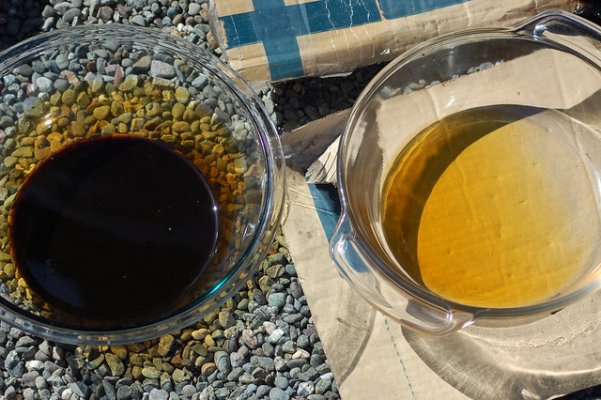

Here is my oil after 14 months on a RP filter, no not the new oil -the oil on the left. It doesn't smell rancid at all, in fact still smells new and is just the dark side of Amber, Tossing this would be a waste, especially at near 100 bucks for an oil change. And this is the oil from the filter, usually the worst and it is in good shape. On the dipstick this still looks new, not black at all. Depends on what oil you are using, but in my opinion ester based oil will be working better then brand new mineral oil. If you would ever like a professionals opinion on how your oil is holding up after a year of service, just send a sample for 35 bucks with a tbn to blackstone and find out for yourself. The short oil change interval was necessary with old technology, but these super oils and super oil filters really are fantastic.

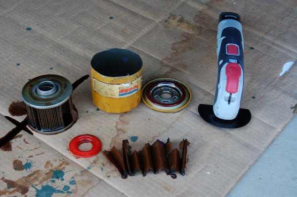

You wouldn't see big holes, you wouldn't see any holes. They happen at the bottom of the pleet and it would likely be a rip or tear, and did you bother to feel the paper? If you are going to tell me it was fresh and not harder then cardboard at 9k miles for a paper filter, I call that bs and bad information. You can read the syn thread, I cut my purolator (yellow) open after 5k miles, and it was stiff as a board.
Here is some hype for ya, this filter was toast at 5k. When the paper gets stiff, it no longer filters worth a damn, there is a tear somewhere and larger micron particles are floating around your engine.
9k on a paper filter and you think it is just fine = Hype.
