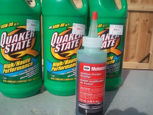

Use the 80w90 GL 5 and Ford friction modifier as per the book. The modifier that comes with the unit is Ok but I hear it is sometimes cloudy with sediment. No whine or howl here, just changed the oil last week after 15 months. So 10 bucks a quart now vs 20-30 for the full I used to have to buy. Side note is i now put full synthetic in the front diff as was recommended by the gear center, Pic for ya, and I loved walkin into the Ford Dealership for my Ram ($5.40 ea).

Only have a 3G but i have been running my Auburn and 4.56's for almost 2 months and just recently replaced the fluids after the 500 mile break in. Very very nice. Used the same Ford Additive but used Valvoline 80w90 conventional since that's all they had at the Oreilly store i went too.
